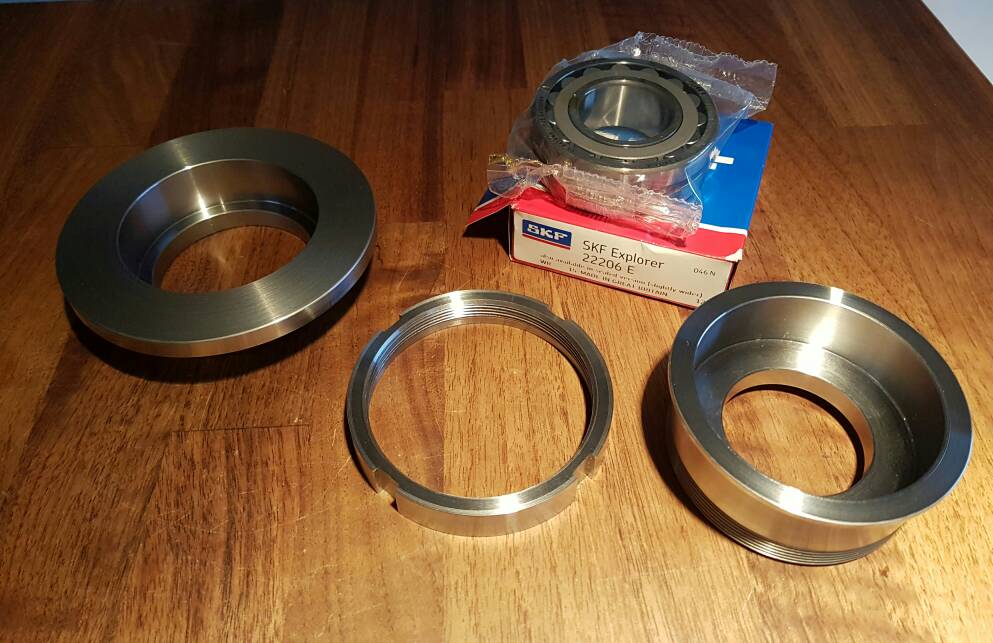

  • We have done a lot of calculations/simulations during the winter/spring. We have found out that we would have to make extensive modifications to the crank shaft, to be able to reduce the bending. There is not only one single modification that will solve the problem. I have instead chosen to let the crank move freely and replace the main bearings for spherical roller bearings. They are a bit "over-kill", but they will allow the crank movement and cope with the radial stresses.
